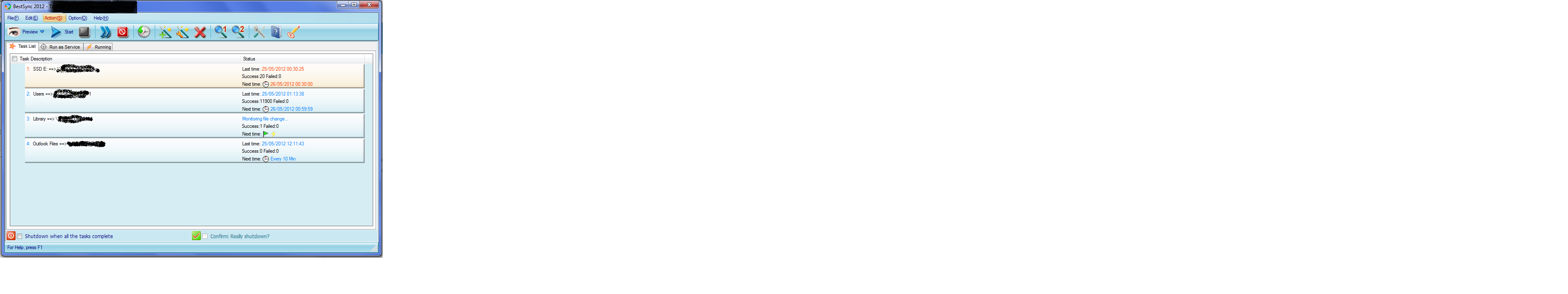

Thank you. I tried this approach. I have just upgraded from BestSync 2011 to 2012. I noticed that when Task Overview is not displayed in the main window (by Option > Option > View), then the check-box to select tasks for /startup is also not displayed. (See screen shot.) Thanks.
Screen shot of screen without check-boxes available.
Screen shot.png (175.22 KiB) Viewed 16456 times

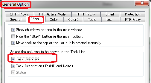

Re: Editing task files
Please try to select the option as the attached graph to show the task details.
Or please size the Main Window to see if the size of the column will be changed.
General Option - TaskView

Changing the size of the Main window (including > Maximize) does not make any difference.
If I select Option > View > Task Overview then the check-marks do display but this is not the same as having the simple display of Task Description only, which is an editable text. Task Overview is not editable to make it easy to see which task is which.
This problem did not occur in BestSync 2011; it started only when I upgraded to BestSync 2012 last week.
If size the column, can the task overview be displayed?
gdu90
Posts: 15
Joined: Wed May 18, 2011 9:27 am
Post by gdu90 »
If Option > Option > View > Task Overview is selected and then the Task Overview column is sized to zero width, then the check-boxes are displayed. Thank you.
We'll improve the upgrade program to avoid this problem.
Thank you.
If you have resolved the problem by sizing the column, then you need not the fix any more.
This problem only happens when read saved setting of the old version.
