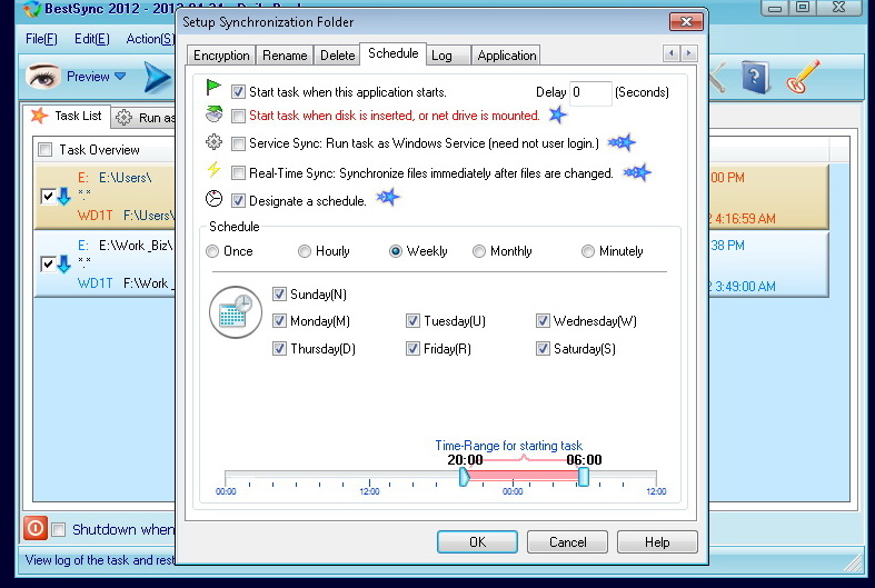

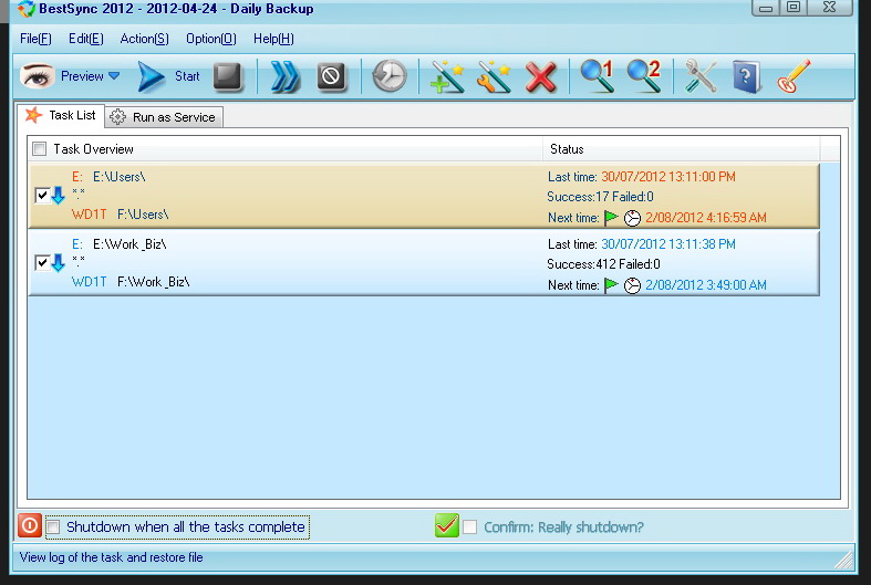

hi,
I have nominated a scheduled backup using weekly and selected each day to backup. However the logs are showing that nothing is happening.
As you can see from the screenshots the backup is clearly scheduled however the logs indicate nothing is going on.
Can anyone provide some pointers as to what is going wrong here.

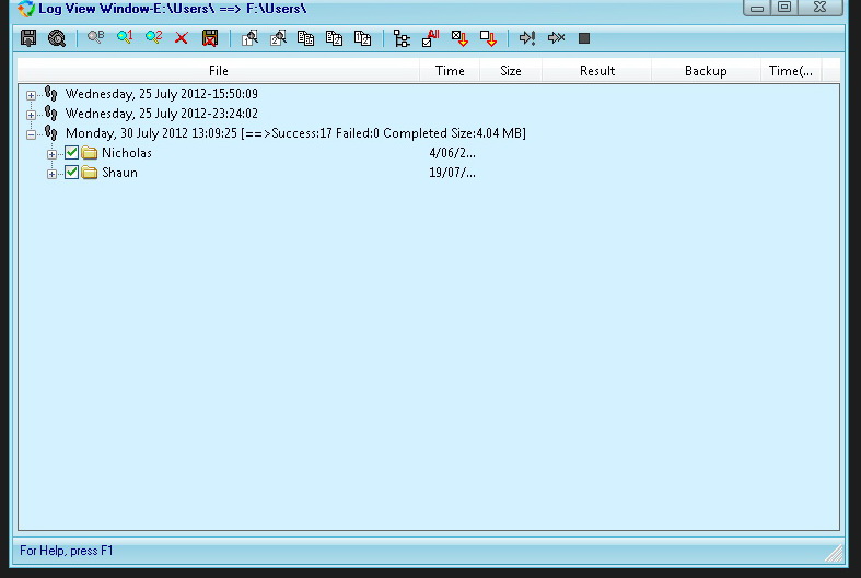

Re: scheduled backup not working
Because BestSync will not add the log record if no file is synchronized and no error happens.
If you want to know if the task has been started by the schedule, please click "Option"/"View Log File" to see if there are records about the task.

Firstly - thanks for the prompt response. Files have been changed - several! But it's not syncing. I have of course viewed the logs and there is no activity for the days in question despite new files being created in the relevant folders and others files modified in these folders.
Next steps to look at would be greatly appreciated.
I noticed that the "Time range for starting task" is "20:00 ~ 06:00", if BestSync is not running during this time range, the task will not be started.
sirslinky
Posts: 7
Joined: Wed Aug 01, 2012 3:32 am
Post by sirslinky »
Hi - what is the problem with that time range? What is the point of a 24-hour schedule if you can only run it at a certain time of day ... not really 24 hour schedule is it? I'm confused.
The time range is for Bestsync to start the task, if Bestsync is started out of the time rang, Bestsync will not start the task.
If you need the task run at any time of the day, please set it to "00:00~23:59".
