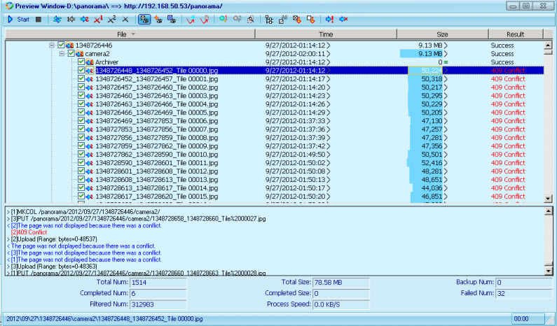

I have attached a screenshot of the error as it appears.

409 error is returned from the webdav server, may be because that the parent folder does not exist when upload the file, or the property of the file is read-only.
BestSync should create the folders before upload the file, but may be failed, please check if the account has the privilege to MKCOL (create collection), and if the server let the client modify property (PROPPATCH).
If you can export the task setting to a file then send to risefly(a)risefly.com, we would like to debug this issue.
