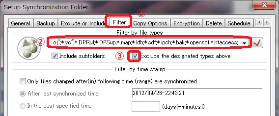

For excluding files with specified extensions, please use the "Filter" tab like the attached jpg file.
[attachment=0]Wz_FilterExt.jpg[/attachment]

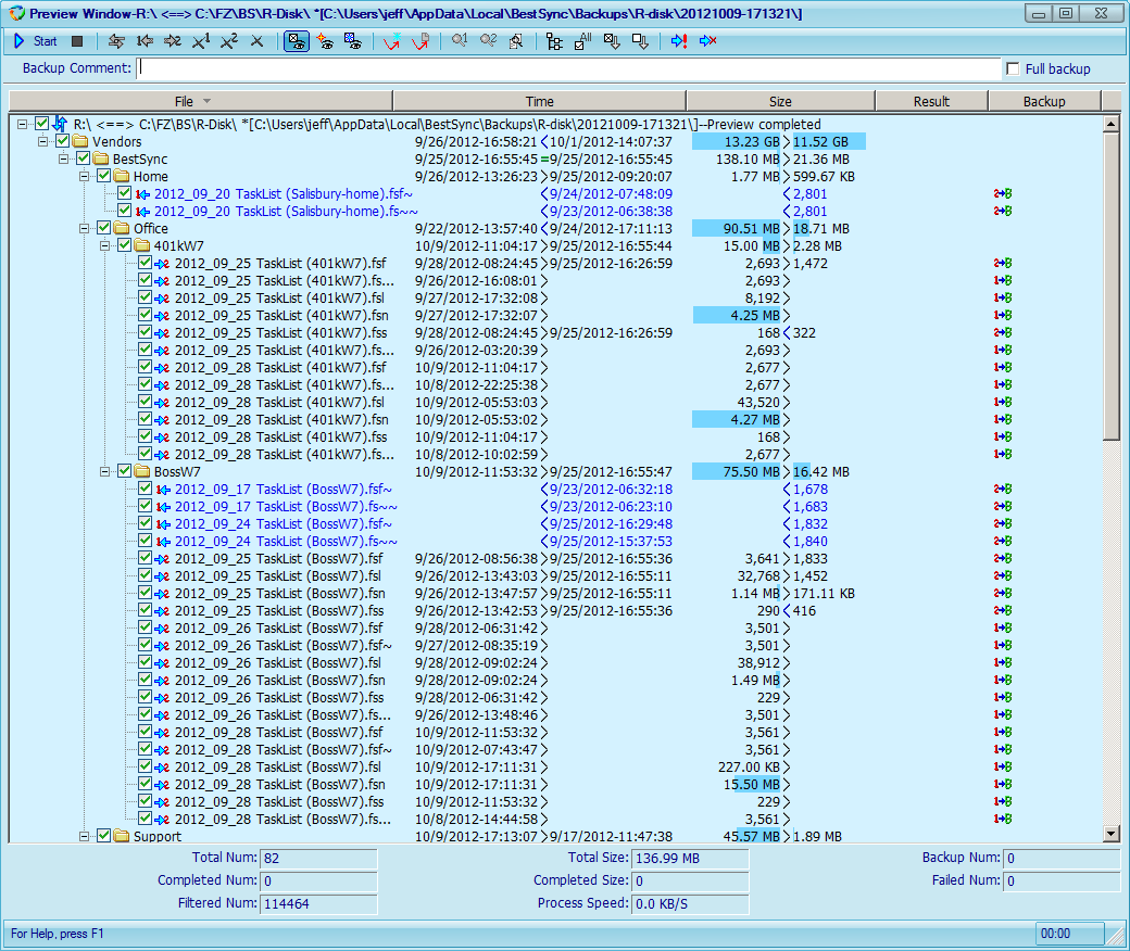

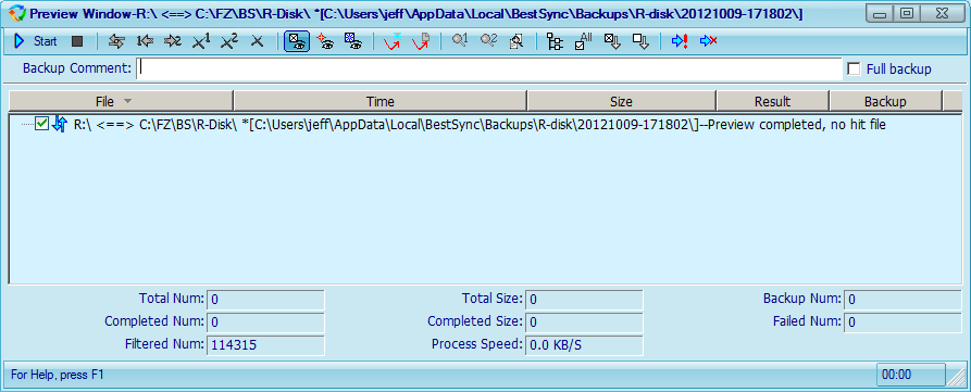

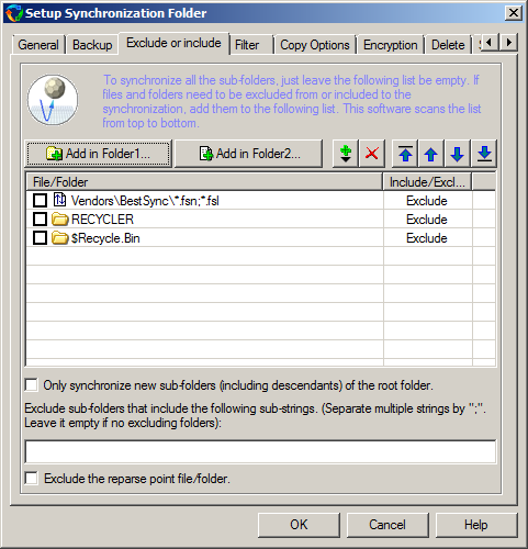

I have created a wildcard exclusion for a subfolder. However, it seems to be excluding the entire subfolder and not just the files that match my wildcard pattern. I followed your instructions to "Add one file for edit", and then separated multiple patterns by a semi-colon. Here's my actual exclude string:
Vendors\BestSync\*.fsn;*.fsl
Below, I show two examples:
EXAMPLE 1 shows the BestSync task "Exclude or include" control BEFORE I add the wildcard pattern, and then Example 1 also shows the resulting Preview window. As you can see from the Preview window, there are many subfolders and files.
EXAMPLE 2 shows the BestSync task "Exclude or include" control AFTER I've added the wildcard pattern. Then, in the Preview window you can see that all files and subfolders were excluded (not just those files that match the wildcard pattern). I expected BestSync to only exclude the files matching the wildcard pattern "Vendors\BestSync\*.fsn;*.fsl". Instead, BestSync seems to exclude this pattern: "Vendors\BestSync\*.*"
Am I misunderstanding how to use this control? Or, is my syntax incorrect?

- EXAMPLE 2: Preview After Wildcard Added. All files in the subfolder were excluded. Shouldn't the only files excluded by those that fit this patter? *.fsn and *.fsl
- Example2b.png (21.27 KiB) Viewed 10542 times
Re: Problem Excluding File Types
Version 7.3.23 has fixed the problem, please try the new version.
