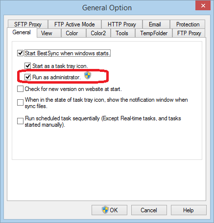

Re: warning:failed to copy NTFS privilege
Please start BestSync as Administrator.
And please confirm the following option is checked, "Run as Administrator" option will take affect at the next time when the PC is rebooted.
[attachment=0]RunAsAdmin.png[/attachment]
Run As administrator
