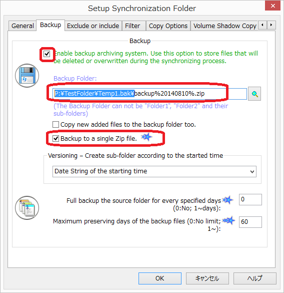

I have tested this issue, the result is OK.
If you want to backup the files to a ZIP archive, please set the backup setting like the following bitmap:
[attachment=0]zip_bak.png[/attachment]
And please note, to use this feature, you need the Premium License at least.

- Backup file to a zip archive

Re: Backup to Single Zip File Not Enabled
Great, thanks!
I didn't realize that I had to specify the name of the zip file, now it works.
