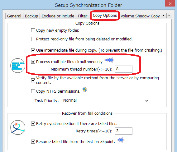

Hello there,
Our hostingprovider has blocked bestsync beacause it uses to many (590) ftp connections simultaneous.
Is there a way to limit the number of simultaneous ftp connections so bestsync won't be blocked?
Thanks so far,
Ralph
Re: Limit the Number of Simultaneous FTP Connections
The attached file is the screenshot about setting the number of threads that run simultaneously.
[attachment=0]MultipleThreads.png[/attachment]
You can decrease the number of threads of each tasks to avoid the issue.
