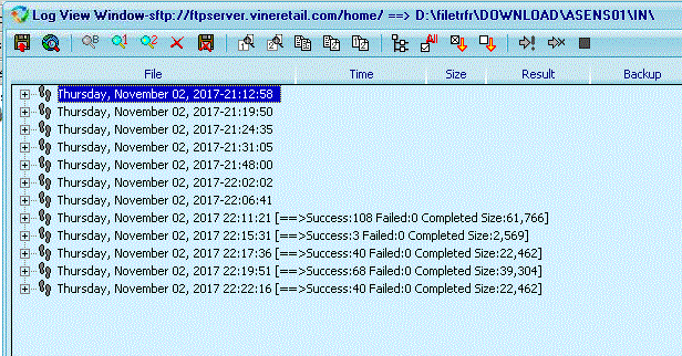

attached is the bestsync log screen shot
the source files get transferred again after I move them to another files.
the source file should only transfer newly created file that have not been transferred yet.
source folder is in amazon. what do I need to do correct this. as I could not downgrade it back 2015 since it hit another bug which I previously report here.

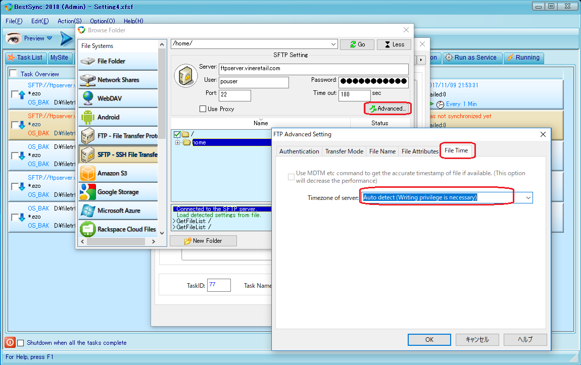

Thank you for the exported task settings.
I have tested the synchronization of the tasks, all work fine on my PC.
I do not know what happens on your server, it seems that BestSync was unable to detect the timezone of the server (May be it failed to write file to the server or the written file was moved during BestSync detecting the timestamp of the written file). You can avoid the problem by setting the timestamp of the server explicitly like the attached screenshot:
[attachment=0]FTP_TimeZone.png[/attachment]
- Set FTP timezone
- FTP_TimeZone.png (134.29 KiB) Viewed 18119 times
