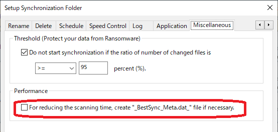

To stop BestSync scanning and remembering the last updated timestamp of an uploaded file, you can uncheck the option "For reducing the scanning time, create "_Bestsync_Meta.dat_" file if necessary. " in "Miscellaneous" Tab of the task setting.
Please try this method to see if it can resolve this problem.

- Uncheck use meta file
- Uncheck_use_meta.png (10.34 KiB) Viewed 17567 times

Thanks for your response. I have made the change as described. It looks like the files are being transferred now. The scanning time has been increased by ~8 sec though but it can be ignored for now. Please let me know if you happen to resolve this issue by some way in the upcoming releases. I will update to the new version.
