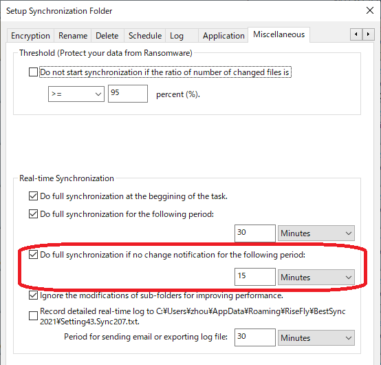

Re: Real-Time Sync not working
If a file system does not support real-time sync, BestSync uses the period option set in "Miscellaneous" /"Real-time Synchronization" to scan the changed files and synchronize them.
The option is "Do full synchronization if no change notification for the following period: [X] minutes".
So changes from WebDAV will be synchronized by the period.
Realtime Synchronization Period
