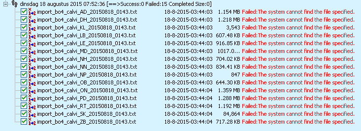

I’m running a task that moves files from a local disk on the BestSync server to a network share on an other windows server. BestSync is running under a service account that also has change rights on the remote share and ntfs.
Everytime the job runs it says it was failed. When I look in the log it says “Failed: The system cannot find the file specified”. But when you look at the destination the files are correcly moved.
What is cousing this behavoir and how can I solve it. We are using the latest version 10.0.3.6.

[attachment=1]Log.png[/attachment]

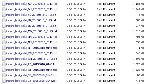

The destination folder.
[attachment=0]Destination.png[/attachment]

- Log.png (22.71 KiB) Viewed 22305 times
- Destination.png (16.84 KiB) Viewed 22305 times

If this was the case, the file wouldn't be moved to the destination folder.

When I run the task in Preview I get exactly the same error. No further or more information is revealed.
We changed the location of the Temp folder to D:\Temp\BestSync and all users, including the service account we are running BestSync under, have change rights at this folder and all above.
In to D:\Temp\BestSync there is no such file as BestSync.tmp. Even when the task is running there is no file.
I can’t find this file on any place on the server.
Many tasks are running fine with no problems.
