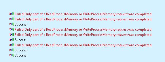

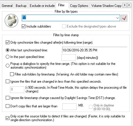

I have multiple task linked together in sequence to send to my FTP site because of limitations of open concurrent connections.
If I select in filter "Only scan the source folder to detect whether files are changed. (Fast, only be suitable for single-direction synchronization" I receive a fail on a file or even multiple files. To me if with that box check it should skip the file/s because it see's no change, why is it a fail? Then I receive a email stating a failed transfer. I'm trying to speed up the process to upload with multiple task.
If I'm doing it wrong... Any suggestions? Thank you.
I've attached the error and my filter setup:
[attachment=1]Capture1.JPG[/attachment]
[attachment=0]Capture2.JPG[/attachment]

Re: Only scan the source folder to detect whether files are changed
I have tested "Only scan the source folder…” option with FTP/SFTP, BestSync works fine.
Please confirm whether you are using the latest version.

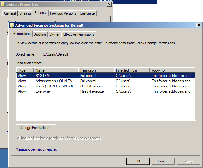

It seems that the error is related to something wrong with the windows.
Please check the following article:
https://kb.plesk.com/en/120909
Cause
Insufficient permissions of the C:\users\default directory.
Resolution
Verify permissions of C:\users\default folder, the correct set is:
Everyone:read, System: full, Administrators:full, Users:read
Risefly,
Under user the folder is named Default.migrated. Any issues with that? Thanks.
