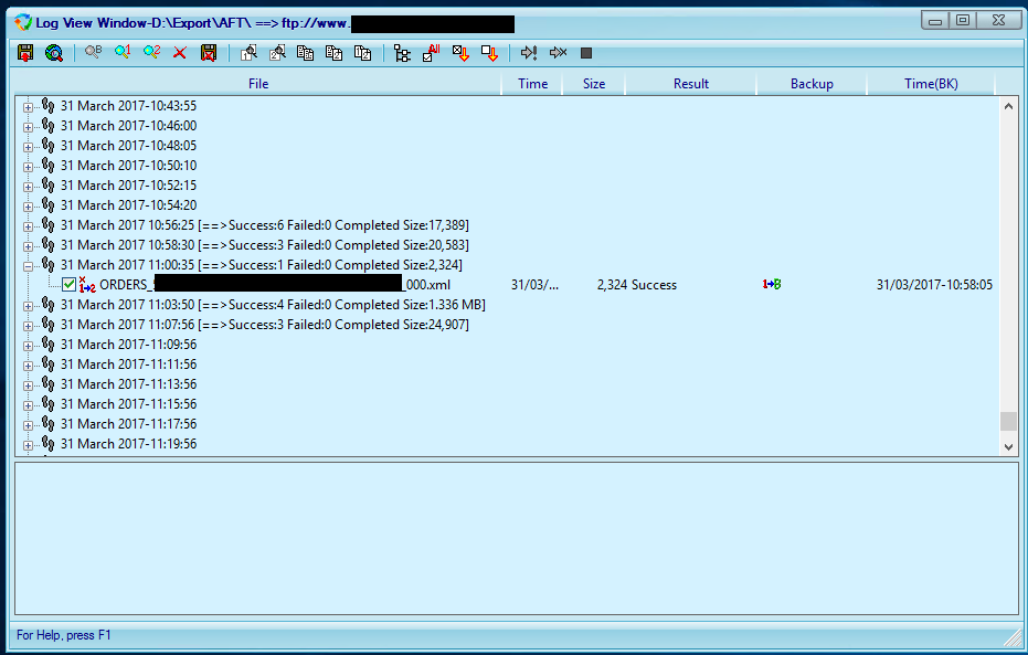

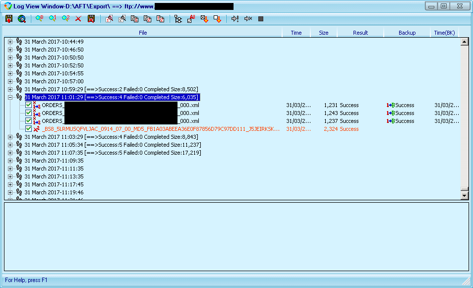

Hello - We currently have 2 servers with BestSync sending files to 1 FTP server/account.
Both BestSyncs are scheduled to send every 2 minutes and back the files up locally.
Whenever the schedules clash (i.e. both BestSyncs try to send data at the same time) one of the BestSyncs records a _BS8_ file as "successfully sent" and the other BestSync records a normal file as sending (when it didn't actually arrive).
I've attached screenshots below to show you what I mean.
Note - One BestSync is 2016 and the other is BestSync 2017.
Any help would be much appreciated!
[attachment=1]BestSync1.png[/attachment]
[attachment=0]BestSync2.png[/attachment]
Re: _BS8_ and missing files!
If you try to upload the same file from two clients (BestSync) at the same time, one of them will be failed.
It may be wrong that you setup two one-way sync tasks from two different clients to the same target folder in the server.
May be you should use two-way synchronization. Two-way synchronization in each client (BestSync) can resolve your problem.
