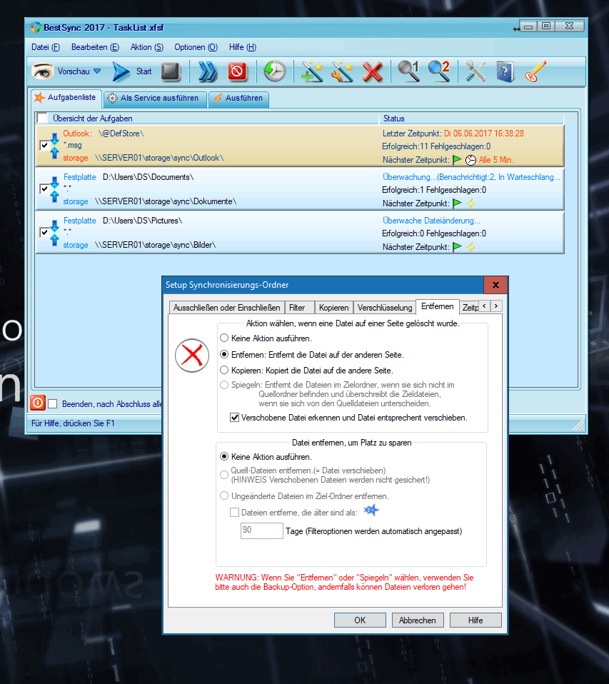

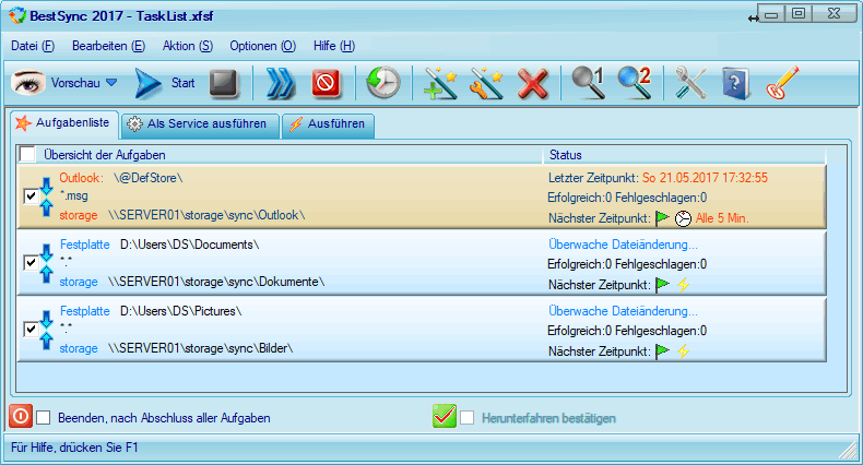

Setup: --> see Pictures.
[Ver12.0.1.1(64Bit)] Deleting does not work
- 2017-05-21_173545.png (26.56 KiB) Viewed 28666 times
- 2017-05-21_173628.png (14.12 KiB) Viewed 28666 times

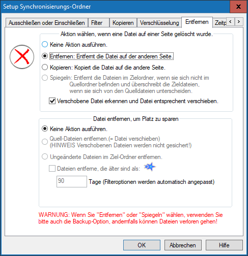

I cannot select mirroring (->Spiegeln), because it is "grey"!
- 2017-06-06_164211.png (83.32 KiB) Viewed 28540 times
