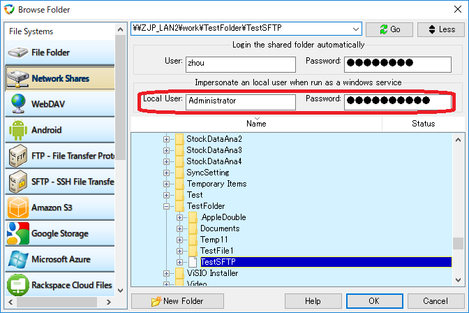

I have found a problem in the setting, you must setup the local PC account in the folder browser of the network shared folder, if the task need to be ran as Windows Service.
See the attached the screenshot:
[attachment=0]SyncNetSvc.png[/attachment]
Sync NAS folder as Service

I added the local user and it still has a status of has not synchronized yet? Sent a new email with the exported task file attached.
