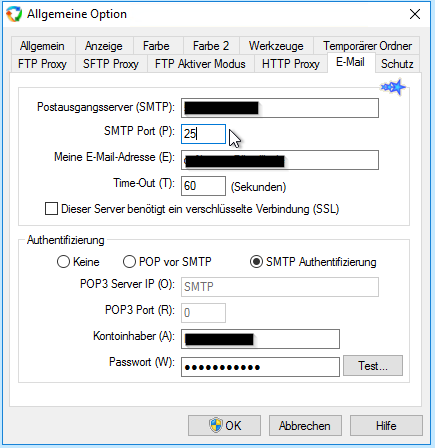

we are using BestSync 2019 (v14.0.1.7). I've set everything fine, see picture "mail settings".

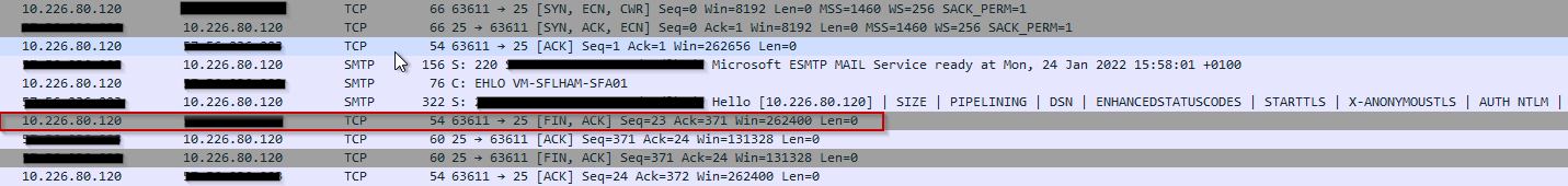

I have also added a screenshot of wireshark, marked the difference to the next below.

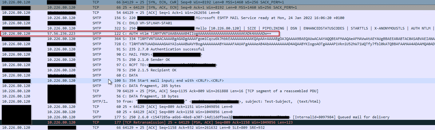

I programmed a little test-tool which uses same server settings and can send emails, wireshark output can be found on the third picture.
Somehow the authentication is missing in the bestsync test.

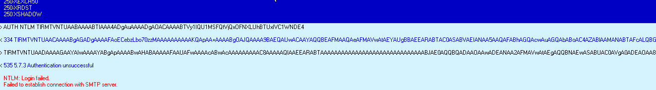

i tried the new version. Sadly it doesn't work yet.
I've added a new screenshot. NTLM authentication starts but gives back a wrong authentication. If you compare the new screenshot with the third one above, you can see, that the encrypted part is different from the working one in my test.

Re: Testing mail settings, not sending a mail, missing authentication?!
We have tested on our Windows Server 2019, BestSync worked fine.
Could you please tell me the version of you windows server, or is it possible that you create a test account for us to debug this problem?
