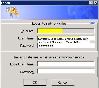

BestSync run as a service using an AD user. This user have Run As Service rights and also have write access to synchronized folders.
- screenshot
- screenshot.jpg (9.01 KiB) Viewed 15016 times

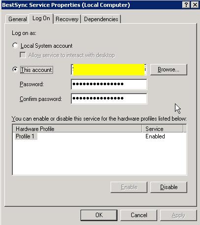

I'm sending you two ScreenShots of my current config.
First is about how all the tasks are configured and the second is for Service config.
Still no luck figuring why all the task freezes with Synchronizing status...
Thank you
Thank you

- screenshot.jpg (24.38 KiB) Viewed 14994 times
- Service config
- screenshot2.jpg (30.53 KiB) Viewed 14994 times

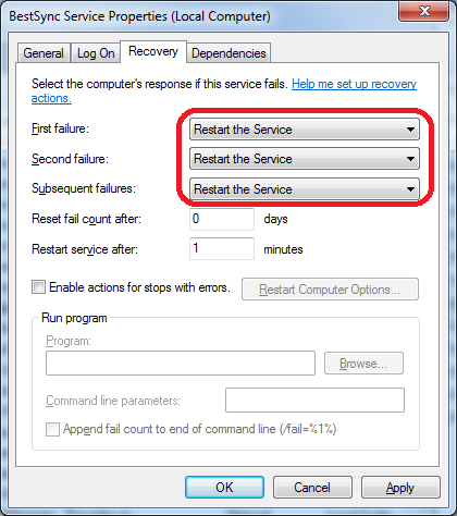

Have tried the following setting to restart the service when error happens:
[attachment=0]RestartService.png[/attachment]
- Restart Service
- RestartService.png (45.49 KiB) Viewed 14795 times
