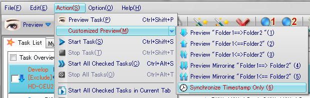

To avoid the problem, and you are sure that the file in Amazon S3 is updated, you can use the following menu to synchronize the time stamp only:
[attachment=1]SynchronizeTimestamp.png[/attachment]

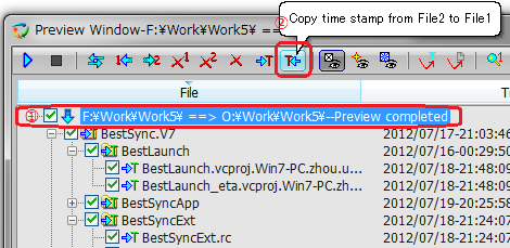

Please note because the "x-amz-meta-lastmodified" can not be modified after file is uploaded, you must use “” to copy the timestamp from Amazon S3 to the local folder.
[attachment=0]ChangeTime.png[/attachment]
