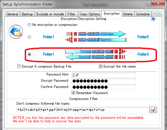

2) Assuming I have this right (in item #1 above), can I modify the above procedure to have the files on the central FTP server compressed and encrypted? In my tests so far using the evaluation version, I can't seem to get the compression / encryption on the FTP server to work. Is that because I'm using the evaluation version?
>For compress&encrypt file in FTP side, just select the following option:
[attachment=0]EncryptFile.png[/attachment]
You can also encrypt the file name. I use this option almost every day to synchronize files by FTP among computers.
