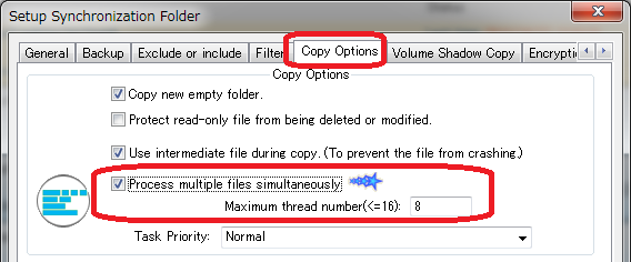

The speed of BestSync is the processing speed of the file contents not the speed of the network transfer.
I recommend you to upgrade to the Ultimate License, so you can use the multiple threads in one task, and this option will boost the upload speed up to multiple times.
[attachment=0]Copy-Multi-Thread.png[/attachment]
Copy Files by Multiple Threads
