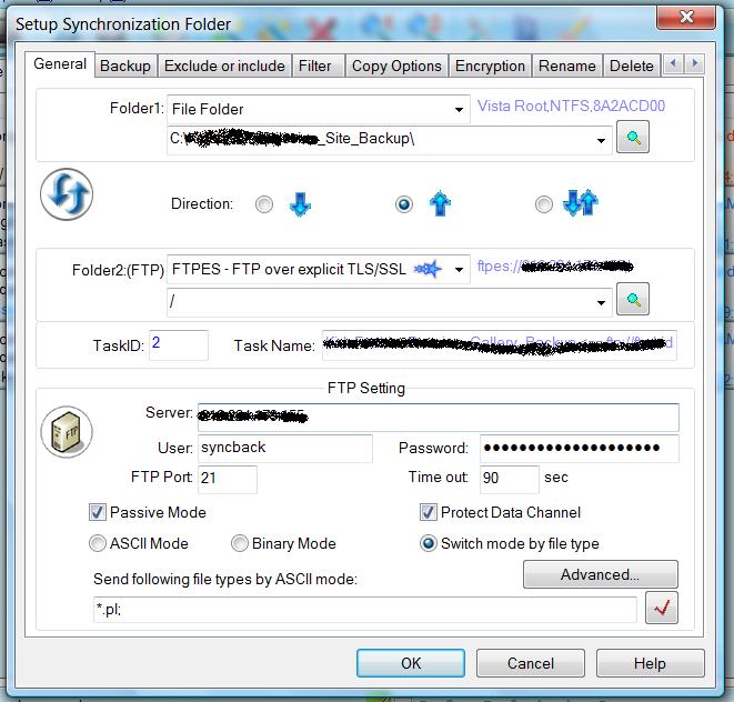

Re: FTPES connection error
It is definitely not set for FTPS. I have attached a screen shot of the setup screen.
This is the log that appears when I try to browse the folder in the setup screen (magnifying glass for folder 2).

- task setup.jpg (77.63 KiB) Viewed 14739 times
