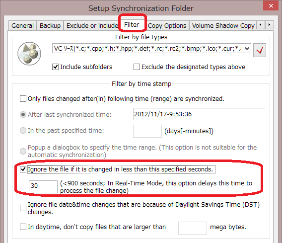

For the real-time issue, how about use the "Ignore the file if it is changed in less than ...." option as the attached bitmap?
[attachment=0]Wz_Delay.png[/attachment]
If you do not want to remove empty folder, please put a mark file like donot_remove.dotr in the folder, and exclude "*.dotr" type in the "Filter" tab.
- Delay-Realtime-Sync
- Wz_Delay.png (27.73 KiB) Viewed 8538 times

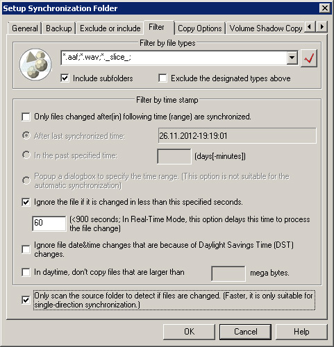

Thank's for quick response.
One problem is solved with use "Ignore the file if it is changed in less than ...." option.
The second problem is a little more complex. Now with BestSync2012 filter only specific file extensions copy to another location.
The filter option is include or exclude, but both need to choose to work copying files which I want to copy and to act protection against deleting folders.
[attachment=0]File filter.jpg[/attachment]
Regards
Vojc
- File filter.jpg (124.6 KiB) Viewed 8531 times

If you have ticked "Exclude the designated types above" option, please add "*.dotr" into the filter types.
If you have not ticked "Exclude the designated types above" option, do not add "*.dotr" into the filter types, just put "*.dotr" in the sub-folders that you do not want to be removed. Because "*.dotr" files will not be copied or removed, so the sub-folders will be preserved.
