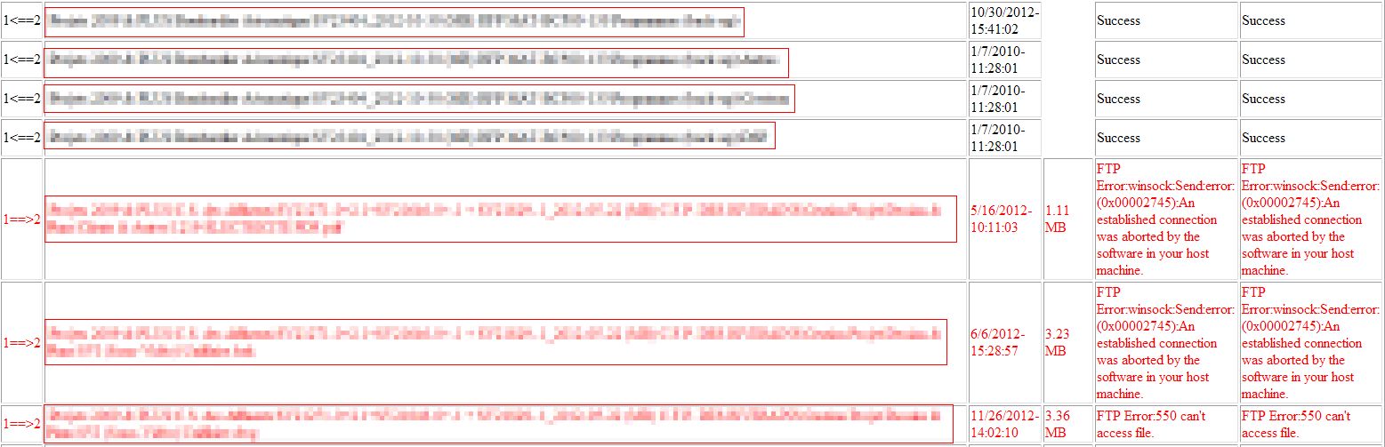

I see in the log file that we have some “success” with the synchronization in both side. I just want to confirm if it is a firewall issue
Best regards,
Best regards,
- log_bestsync
- bestsync_image.jpg (157.64 KiB) Viewed 13549 times
