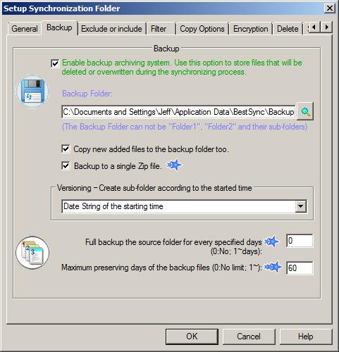

Also, while I've been working around the bug, I've repeatedly toggled the backup option on and off. I've noticed that whenever I enable or disabled the backup option (the top check-box on the Backup tab) BestSync "forgets" some of the other backup settings (i.e. the Backup Folder). Will you please enhance BestSync so that it will always remember all of the backup settings whenever the backup enable option is toggled? See the attachment.
As you requested, I just emailed you the exported task. FYI, I carefully edited the exported task to remove passwords, username, and ftp server. I hope that doesn't cause a problem for your debugging. Let me know.
