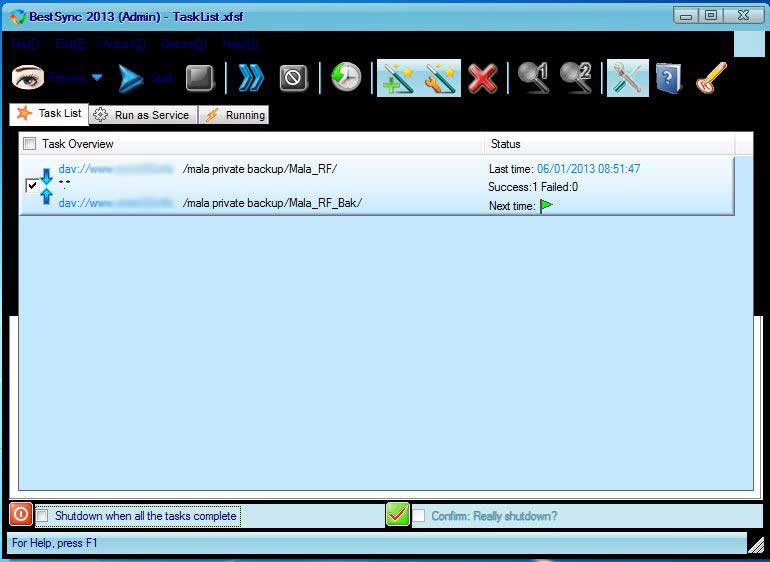

Getting an incomplete GUI, this is the only application with black parts in the GUI
v8.0.1.3 64 bit,
System Spec
Intel i7 4 core
RAM 16GB
Nividia GTS 450 - 1GB GDDR5
win7 pro, SP1
Thanks for the help

For the black GUI, we have never seen this symptom. If you size the window, does this symptom disappear?
Re: WebDAV - connection error - Initial testing

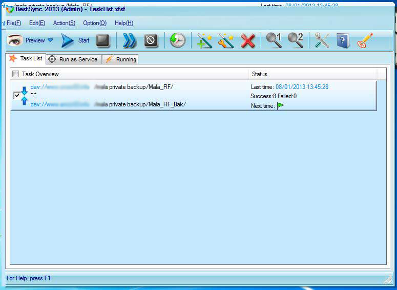

The full screen looks Okay (64bit), when smaller it reverted to this with some buttons missing, I have checked all other applications on my system, this is the only one that is playing up.
