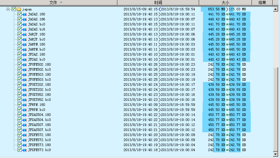

I have two computers work correctly, A and B.
Different computer have a program to compute a output.
Computer A has more input files so it's output is more complete;
the other one B has less input file so it's output is not so complete
what i want to do is compare difference between A and B, if A has file that not held in B, then transfer it to B
cause most of files in A is same as B, i mean filename, file size ,but different in file time .
now the problem comes, bestsync think file time different means file different.
how can i just sync the missing file hold in A to B, ignore the different file time.
how can bestsync ignore time different

Could you please tell me why the files are same but the time stamps are different?
If this is the occasional case, you can use "Action"/"Customized Preview"/"Synchronize Timestamp Only" to sync the time-stamp once, otherwise BestSync can not ignore the time difference.

Computer A and B use same data source provided by satellite receiver. Because different level authority, computer A has more data. The the program run in A and B is same, so the files generated by program ran in A and B is different in time but same in file size and file name. Output in A is more plentiful than B, so i want to copy the file that not hold in B from A.
That's All, thanks for your help

Most files hold in A is not necessary to be transferred to B, if use bestsync now ,we must transfer almost 200G file everyday. In fact, it's only 4-5 G file should be transferred. Can i use bestsync, or i must write something all by myself?

You can use "Action"/"Customized Preview"/"Synchronize Timestamp Only" to synchronize the time stamp of files that have same name and size once.
Then BestSync can synchronize the different files only.
It is best If the satellite receiver can copy the timestamp of the files from the source.
