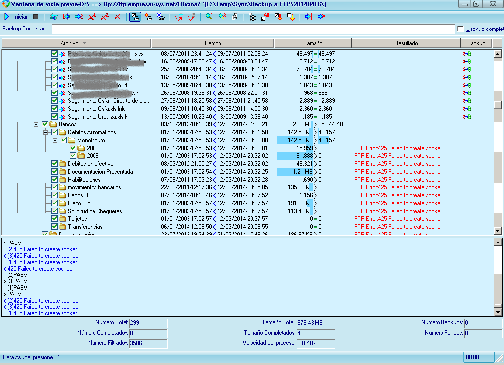

It connects correctly to FTP server because doing a preview most files are attempted to be syncronized but in the same preview it shows some files whit that error message and usually are the same files while others has no problem in the same syncronization as you can see in the example attached where some files are correctly compared then some files or folders with ftp error message and then files correctly compared again and so on
- Example of FTP error message
- FTP Sync.png (83.94 KiB) Viewed 9126 times

At the bottom of the preview window, there log lines "425 Failed to create socket".
Because the error happened at the server end, please contact the developer of the server to see if they can give you any help.
