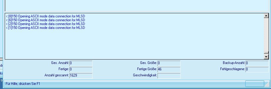

3. The speed of scanning and sync. I know I´ve not the best upload speed, but using filezilla I reach in the middle 4-500 kb/s. Actually I´m looking on my rdp screen and see bestsync scanning. I started this job about 40 minutes ago ( it´s the only one which is on duty at the moment ) and it´s still scanning, I´ve put a new folder in my local drive and it is still not synced. That´s seem for me a littlebit curious, because for this oneway sync it should be only necessary to control the local drive - or?
the local folder has 2012 subfolders withabout 60000 datas. but the most of these folders and in this way the most of the pictures are blocked , bestsync is actually showing "scan (5970)" ( I think we are talking of about 100 not blocked folders andabout 2000 pictures )

- slow.JPG (42.57 KiB) Viewed 9436 times

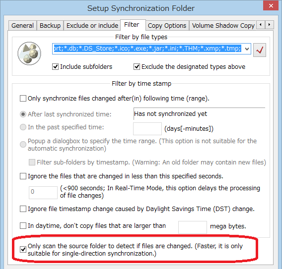

Because the FTP server does not response quickly, and you said that there are 2012 sub-folders, it may take very long time (may be tens of minutes) to detected changed files (scanning files and comparing the timestamp). So if you add some new files to the folder, they will not be synchronized immediately.
Because your task is an one way sync task, it is safe to use the following option to improve the synchronization speed:
[attachment=0]OnlyScanSrc.png[/attachment]
The first time synchronization will still take long time to scan the files, but from the second time, BestSync will use a local database to detect the changed files.
- Only scann source folder
- OnlyScanSrc.png (31.48 KiB) Viewed 9424 times
