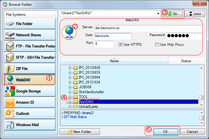

Browse a folder in WebDAV
(1). Select "WebDAV" in the "File System" list.
(2). Setup the parameters for connecting to the WebDAV server.
Server:  The hostname of the WebDAV server, like "dav.server.com". Or the IP address, like "192.168.10.1".
User and Password: The user account.
Port: The TCP/IP port, usually it is 80. If port number is 0, BestSync will use the default port number 80, or if "Use HTTPS" option is checked, port 443 will be used.
Use HTTPS: If this option is checked, BestSync uses secured socket (SSL/TLS) to connect to the server, all the data transferred over the network is encrypted.
If the local computer is behind a firewall or NAT, usually the computer needs the proxy to connect to the WebDAV server.
(3). After set up the host name and account, press "Go" button to connect to the WebDAV server, and list the collections folders in the WebDAV server to the tree view.
The log window below the treeview logs all the commands sent to the WebDAV server, and responses from the WebDAV server. If the connection between BestSync and WebDAV server can not be established successfully, please check the log.
