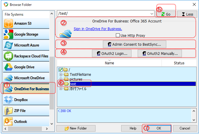

Browse a folder in OneDrive for Business
(1). Select "OneDrive for Business" in the "File System" list.
(2). Setup the parameters for connecting to Microsoft OneDrive for Business.
If you have not got an account, you can click "Sign in OneDrive for Business" link to apply a OneDrive for Business or Office 365 Account.
If the local computer is behind a firewall or NAT, usually the computer needs the proxy to connect to the OneDrive.
(3). Configure consent to BestSync application
BestSync needs "https://graph.microsoft.com/Directory.ReadWrite.All https://graph.microsoft.com/Files.ReadWrite.All " permissions for synchronizing with "OneDrive for Business", these permissions requires admin consent.
If your organization has not configured the consent to BestSync, please follow the below steps to configure consent to BestSync.
a. If you are the administrator of your organization, just press "Admin Consent to BestSync ..." button, in the opened dialogbox, input the tenant ID like "958544??-c6??-4b??-a894-56a86426????" of your orgnization, then press "Open URL" button. In the openned Browser page, just follow the steps to give the permissions to BestSync.
b. If you are not the administrator of your organization, please copy the following URL text, tell the url to your admimistrator, ask your admimistrator replace " {your_tenant_id} " to the tenant id of your organization, then access the url to configure conssent to BestSync application.
https://login.microsoftonline.com/{your_tenant_id}/v2.0/adminconsent?client_id=9de5c5f1-af5b-4c46-9ffb-33b1cc55ad73&state=12345&redirect_uri=https://bestsync.us/oauth2back.html&scope=https://graph.microsoft.com/Directory.ReadWrite.All%20https://graph.microsoft.com/Files.ReadWrite.All
For how to configure consent to application (BestSync) for accessing your data, please refer to the follow page:
https://docs.microsoft.com/ja-jp/azure/active-directory/manage-apps/configure-admin-consent-workflow
This step is an one-time step, from the second time you setup an OneDrive for Business, this step can be skipped.

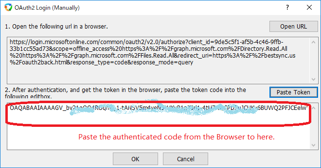

b. If you press "OAuth2 Manually", follow the below steps to authenticate your account.
The "OAuth2 Login (Manually)" dialogbox pops up, press "Open URL" button. In the openned Browser page, just follow the steps to give the permissions to BestSync.

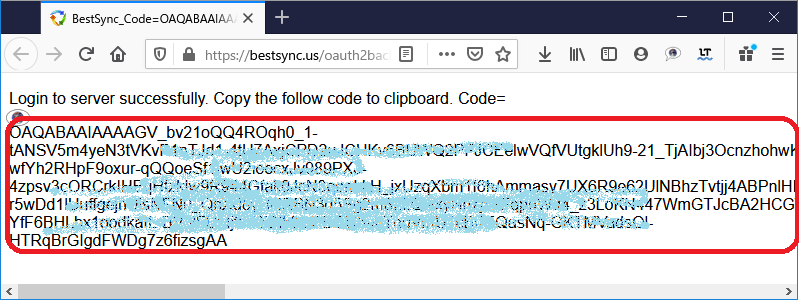

If you login OneDrive for Business successfully, and allow BestSync to access your OneDrive, the authenticated code will be displayed in the browser page, like the following screeshot.
OneDrive for Business Authenticated code Copy the authenticated code in the above red border to the clipboard.
Paste the autheticated code to the "OAuth2 Login (Manually)" dialogbox like the following screeshot.
Press "OK" button to complete the authentication.
(5). Click "Go"button to refresh the folder tree.
BestSync lists all the folders in OneDrive for Business, and display the folders in the file tree.
The log window below the file tree logs all the commands sent to OneDrive for Business, and responses from OneDrive for Business.
If the connection between BestSync and OneDrive for Business can not be established successfully, please check the log.
(6). Select the folder in the folder tree for synchronization.
(7). Click "OK"button to end the dialog box
