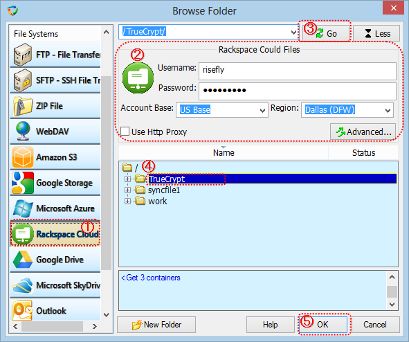

Task Wizard: Browse a folder (container) of Rackspace Could Files
Browse a folder in Rackspace Files
(1). Select "Rackspace Cloud Files" in the "File System" list.
(2). Setup the parameters for connecting to the Rackspace server.
User Name: The Rackspace account.
Password: The password of the account.
Account Base: "US Base" or "UK Base".
Region: "Dallas (FW)" or "Chicago (ORD)".
If the local computer is behind a firewall or NAT, usually the computer needs the proxy to connect to the Rackspace server.
Advanced...:
Setup the customized meta-data to the file that upload to the Rackspace.
(3). After set up the parameters above, press "Go" button to connect to the Rackspace server, and list the containers (folders) in the Rackspace server to the tree view.
The log window (below the treeview) logs all the commands sent to the Rackspace server, and responses from the Rackspace server. If the connection between BestSync and Rackspace server can not be established successfully, please check the log.
