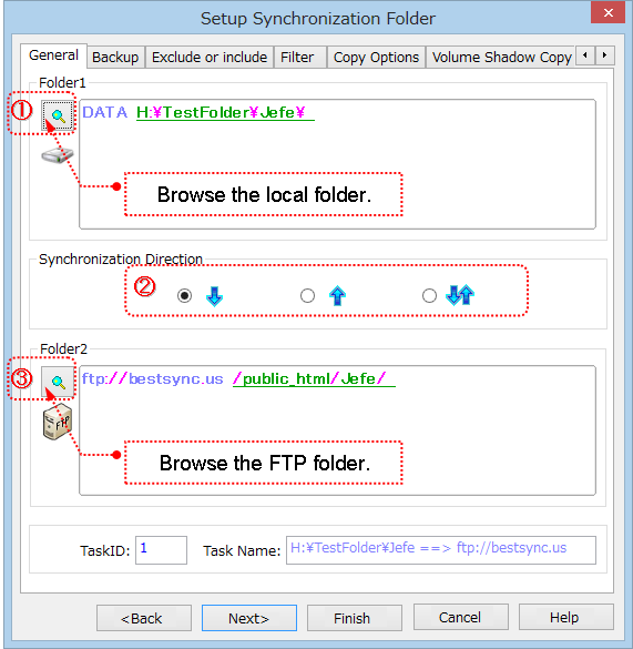

2. On the "General" wizard page, set the local folder, synchronisation direction and the FTP folder like the following graphs.
(1). Click
to select the local folder into the "Folder1" edit box.
(2). Select the synchronisation direction.
Two-way synchronisation.
(3). Click
to start the browser to select the FTP folder into the "Folder2" edit box.

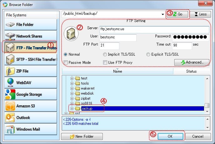

3. Browse the FTP folder.
(1). Select "FTP - File Transfer Protocol" in the "File System" list.
(2). Setup the parameters for connecting to the FTP server.
Server: The hostname of the FTP server, like "ftp.server.com". Or the ip address, like "192.168.10.1".
UserandPassword: The user account.
FTP Port: The TCP/IP port, usually it is 21.
Please add this port to the exception list of the Windows Firewall and Anti-virus software, otherwise the port may be blocked.

(3). After setup the FTP host name and account, press "Go" button to connect to the FTP server, the browser begins to list the folders in the FTP server to the tree view.
The log window belowthe treeview logs all the commands sent to the FTP server, and responses from the FTP server. If the connection between BestSync and FTP server can not be established successfully, please check the log.
